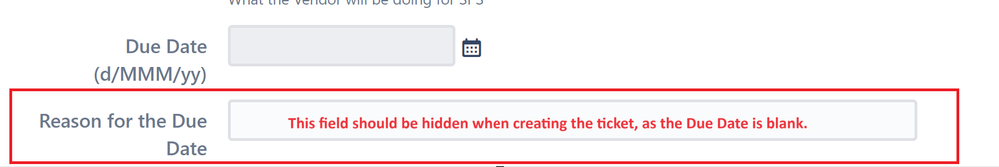

I am trying to create a script that shows or hides a single line text field called "Reason for the Due Date" based on the value of a date field called "Due Date". Although the script is working, the "Reason for the Due Date" field is visible when the ticket is initially created, even when the "Due Date" field is blank. Ideally, the "Reason for the Due Date" field should only be visible when a value is entered in the "Due Date" field and should disappear when the "Due Date" field is blank.

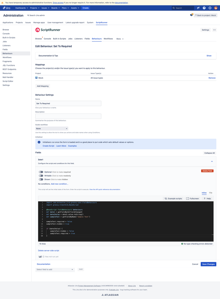

Below is a screenshot of the Behaviour configuration for your reference:-

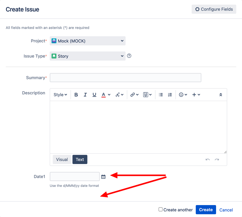

1. The Date field is empty by default when the Create screen first appears. Hence, the Text Field is set to not required and is hidden.

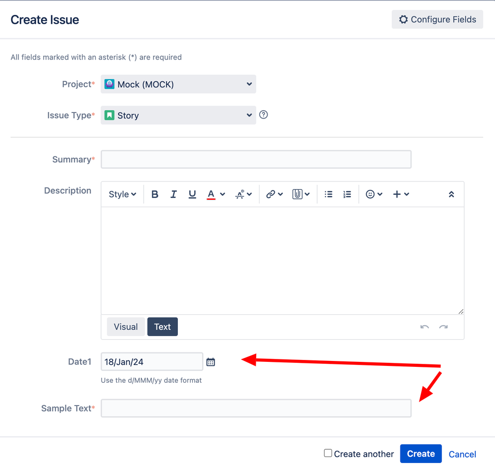

2. When the value is set for the Date field, as expected, the Text Field is now visible and is set to required, as shown in the screenshot below. If the Date field is cleared, the Text Field will not be set to required and hidden as expected.
