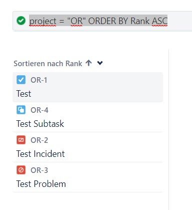

Hi @Manon Soubies-Camy
i just checked the filter and it is the default "project = "OR" ORDER BY Rank ASC"  and this filter also shows me all 1.jpg

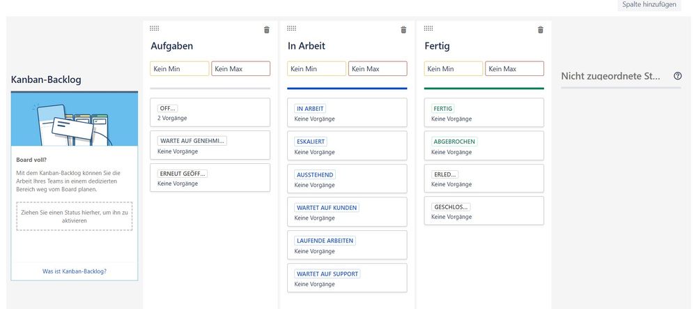

Thanks for these screenshots, it's helpful. What is your Kanban board sub-filter?
Can you also check your incidents and problems status? Are these statuses mapped to any column in your board (see Configuring columns)?
Marco
May 29, 2019
The Kanban Board Subfilter is the default one: fixVersion in unreleasedVersions() OR fixVersion is EMPTY . I tried to change it to issuetype with all of the 4 types or completely removing the filter but it did not help.
All of the Issues are currently in the status open but not even mentioned in the column configuration (sorry for the german language in the screenshot)

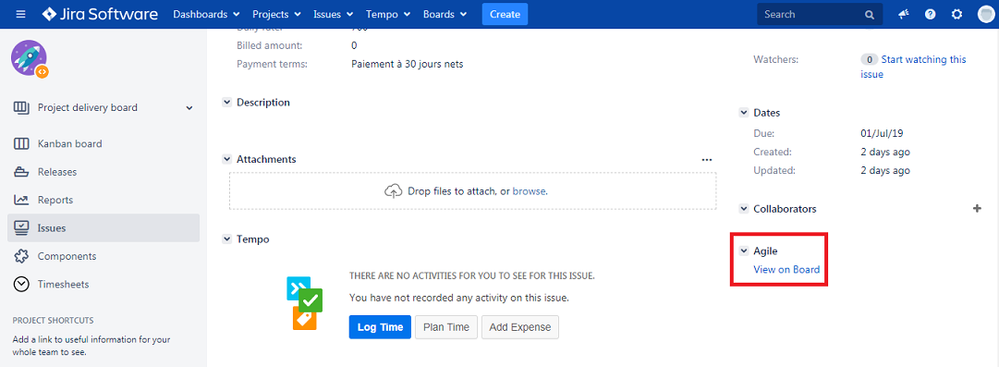

@Marco - I don't have any Jira with both Jira Software + Jira Service Desk to try it out right now, but do you have a "View on board" button on your incidents and problems?
Marco
June 3, 2019
they had different workflows but that did not do anything since i tried to give the inc/prob the same workflow as the tasks.
I cannot find a "view on Board" Option in our cloud instance.
