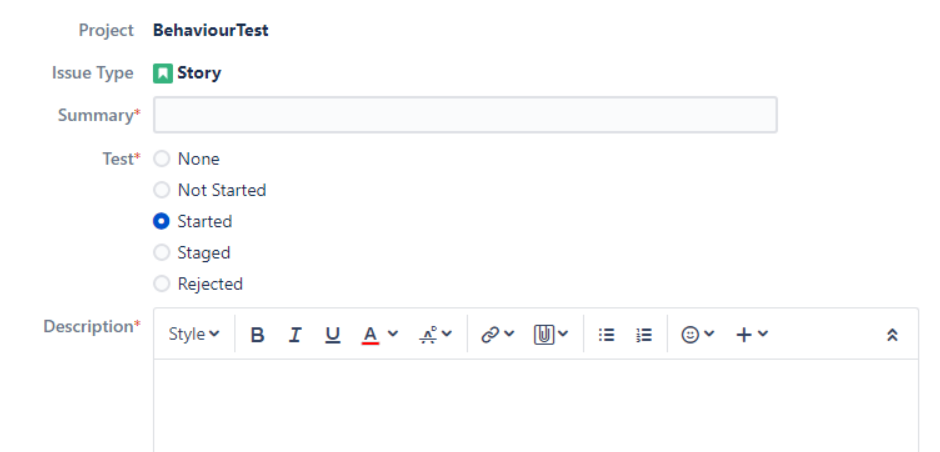

I have a radio button type custom field "Test" with options "Not Started", "Started", "Staged", "Rejected" while creating the issue in Jira.
If option "Started" is selected in the radio options, a custom field named "Flow" need to appear on the create screen, if any other option is selected "Flow" custom field should be hidden.

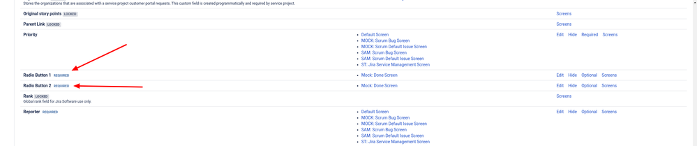

  2. Next, go to the field configuration page and set your Radio Button fields to required, as shown in the screenshot below:-
  3. Next, re-enable your Behaviour but ensure the required option for your radio button is removed.
  4. Now go to your issue, refresh your browser, try to create an issue and check if the None option is still visible for the Radio Button.
  5. If it does not appear, try to select one of the options on the radio buttons. Then, go back to the Field Configuration and set the Radio Buttons back to optional.
  6. Next, re-enable your Behaviour, set the Optional / Required toggle for your radio button to Required and try to re-test it once again to confirm if the None option is available now.

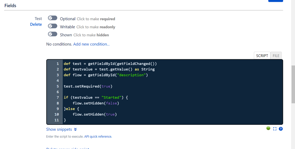

Hi @KSKumar55  Kindly apply Behaviour on Test Field, like below screenshot :-
Instead of making field mandatory from Behaviors, it would be better use Field Configuration for making field mandatory , so that None option won't visible on screen.
def test = getFieldById(getFieldChanged())
def testvalue = test.getValue() as String
def flow = getFieldById("description") //replace with your custom field id
test.setRequired(true) //kindly make field mandatory from field configuration
if (testvalue == "Started") {
flow.setHidden(false)
}else {
flow.setHidden(true)
