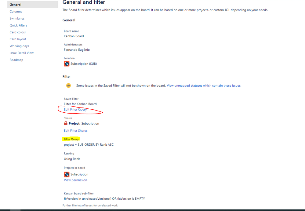

You can validate if the filter that extracts issues from the other project is applied in the card configuration.
In the structure settings, in the option "Filter query", you can see the JQL which is used to fetch items.
To edit it, it is necessary to create or edit the filter applied in the panel, for that click on "Edit filter query" and apply the new search.

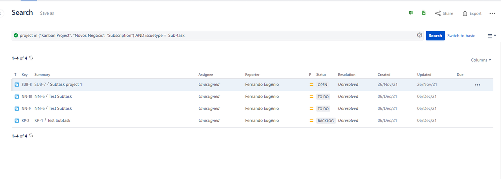

Then save and check if the board already has the new subtask issues. See an example:
