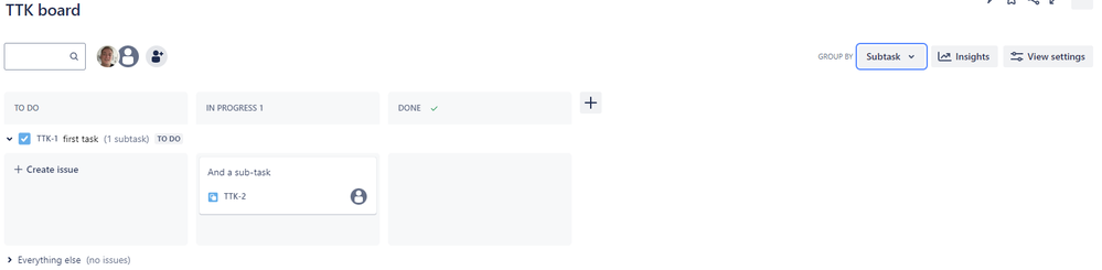

the only reason I can think of why "Group By" will not give you the Subtask option is that your project is missing the Subtask issue type. Did you check under Project settings > issue types if you have a subtask issue type?
If you do it should work and look like this:
