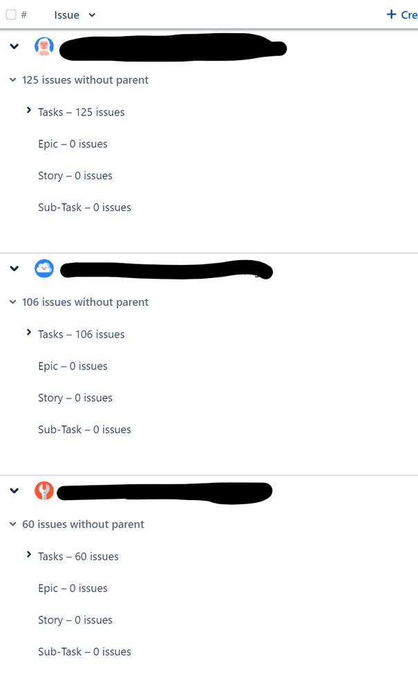

Thanks Alex,
Please see attached advance roadmap screenshot.

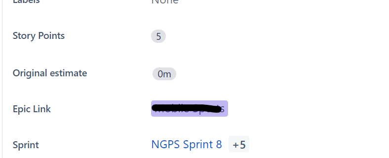

Somewhat confusing to me is that there are tasks showing under tasks in it's own category instead of grouped within the Epic, which the task is linked to the Epic itself.
Is this because that the issue types are not tied with a parent?
Reagan Cha
Linked using the Epic Link? Or linked using Linked Issues?

Hi @Reagan Chan ,
Are you using company or team manage projects? If company managed, you either need to select the hierarchy drop down and change the level but a screenshot would be helpful.
