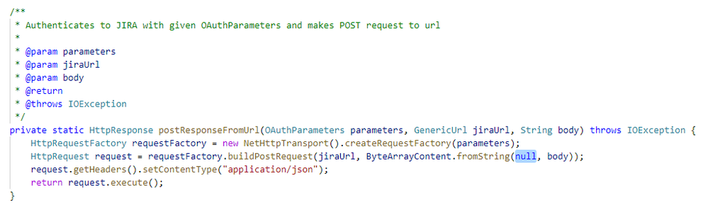

sriprasanna.mg
November 6, 2020 edited
Hi Stephen,
Thanks a lot for the reference. Following the guide it was possible to make successful REST calls - GET with oauth.
But we are now I am stuck with POST calls. Is there an example to do that?
I tried to extend the OAuthClient.Java with this method but always ends up in Error 405 - Method not allowed

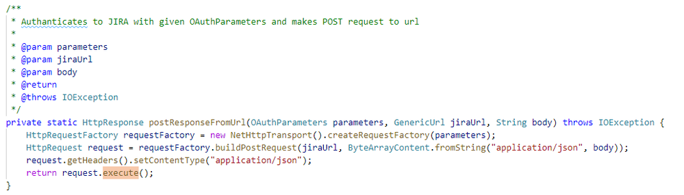

sriprasanna.mg
November 9, 2020
Problem is fixed!
Also make sure that the POST request body is specified correctly:
In my case I used VS Code for debugging - the double quotes are escaped properly only on using three backslashes \\\
Eg:
"{\\\"globalId\\\"\\\"82411\\\",\\\"object\\\": {\\\"url\\\"\\\"http://google.com\\\",\\\"title\\\"\\\"This is a remote link\\\"}
