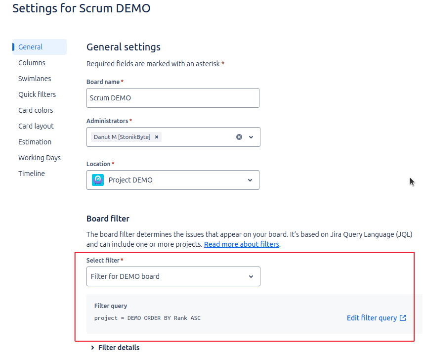

Hi @Justin,
No. The sprints are linked to a board, not to a project.
Each board use a Jira filter behind, and that filter returns the issues displayed by the board. By default, that filter includes only the current project, but you can change the board filter as you want, by including issues from multiple projects in your case.
Go to Board configuration > General tab to see the board's filter.
Danut

Yeah, because if an issue from a board is also visible in the other boards (due to board filters), the sprint of that issue will become visible in the other boards.
Sprints are linked to boards. If you'll try to access the details of a sprint via REST API /rest/agile/1.0/sprint/{sprintId} - see https://developer.atlassian.com/cloud/jira/software/rest/api-group-sprint/#api-rest-agile-1-0-sprint-post - you will see that the sprints have an originalBoardId field representing the board where it was created; there is no direct link to the project.
Danut.

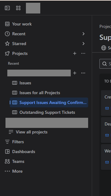

Hi @Sherwin Soriano - thanks for helping.
I have two simple PROJECTS. Each has the default board that is created. So that's what I mean by saying that i have a "board as a project".
In Project_A i ended up creating a 2nd board which was then customized to show all issues from both Projects. As stated above, I think this is smelly/hacky because this project can now see issues OUTSIDE of this project. but that is the suggestion / what people keep saying todo.
