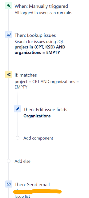

Interesting automation you got there! You are not far from making your rule working. You've got almost everything figured out! However, the one tiny little piece that's missing is the lookupissue action, which you must place after the trigger. Please find below my rule, with slight modifications (to trigger, one project scoped etc):
Now this rule was built only for a single project, but of course you can add you else statements after the first if. Keep in mind of the limits you have when executing rules across multiple projects.
The only thing that was missing from your rule was the lookupissue. Ohh.. and you might need to modify the email HTML to be a bit more presentable (at least on my outlook client, it's not that presentable). Btw, in what plan do you have your JSM?
Let me know if that works!

Hey @Spiros P.
Organizations are not included in {{lookupIssues}} properties.
You don't need the Organization field on the lookupissue. You only need to lookupissues where the organization is empty. The JQL I've given you is valid and tested by my side. Unless I'm missing something.
But what if it executes for multiple Projects? It doesn't feel right to enable and receive many emails by action
It doesn't matter if the rule runs across multiple projects. I mean you lookupissue will search in these multiple projects, it will perform separate actions, but in the end of the day you will receive only one email with all the issues from all projects.
