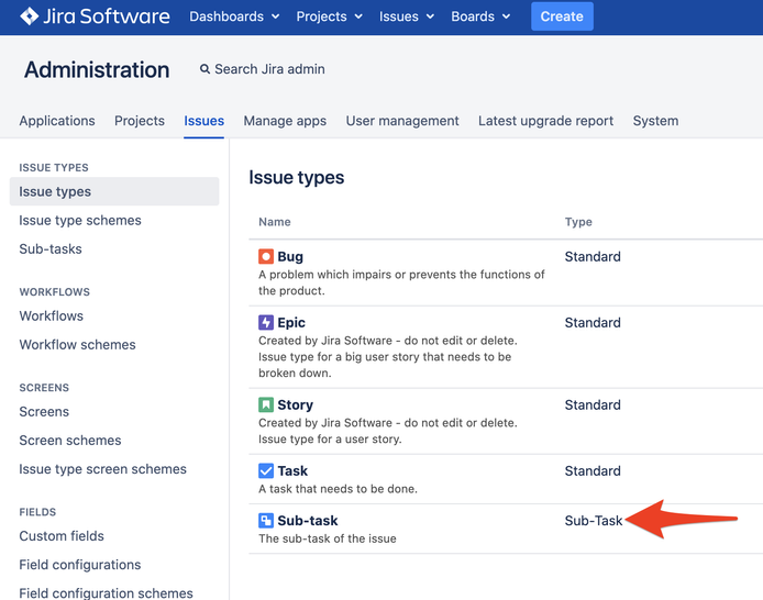

  1. Can you confirm the issue type you're having trouble with is listed as a "Sub-Task" type in the Issue Types administration page in Jira?

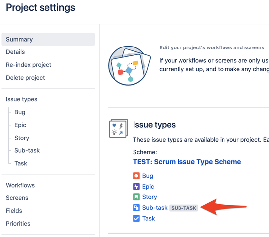

  2. Can you also double-check that the issue type that you're trying to work with is listed in the Issue Type scheme assigned to the project, and has the "SUB-TASK" lozenge there? This is viewable on the "Summary" page of the project's settings:

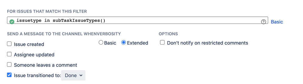

  3. Please switch your Slack notification filter to "Advanced" mode and copy the JQL here for troubleshooting. At the issuetype level, we're checking that it's set to
    issuetype in subTaskIssueTypes()
