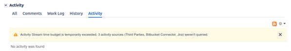

Also we have some strange warnings like "activity stream time budget is temporarily exceeded".

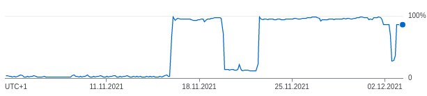

Contrary to the first post, we recognize serious changes in the CPU load as you can see here:
We have excluded that this is related to our usage because we have the same load on a Jira test instance with nearly no interaction on it.
We really appreciate any help on that issue. Thanks!
I also have experienced performance issues (especially in memory usage) after upgrading to 8.13 from 8.5. Atlassian support solution unfortunately was to "increase memory" but I could not figure why the it was suddenly used to its maximum, causing shutdowns (same curve as above).
