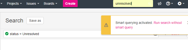

If you enter into Smart Query the following:
I have always seen that you get back the JQL of:
But we are getting:
I believe I have correctly confirmed that there isn't a Resolution of "unresolved" by the following:
and
and
both return the same number of issues.
I have also confirmed that there is not a Status of "unresolved" set.
Also, I've confirmed removing the Project from the Smart Query as unresolved, still queries the Status = unresolved JQL, not Resolution = unresolved.
We have Server 7.3.6.
What am I doing wrong?

I don't appear to be asking my question correctly and it appears that folks are believing this is just the old resolution field is not EMPTY problem.
My problem isn't with the resolution field, it's with Smart Query.
Entering in unresolved into the Smart Query field gets:
which is resolving to:
and not resolving to:
as it should.
What can I do to diagnose why this is happening?
Thanks!
Rick
