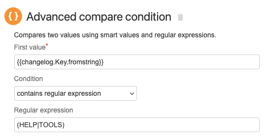

My task is to set security level when an issue is moved from an internal project (with no security) to an external project (level is critical to keep our customers in their own tix only). I want to use the project key and not the project name...
Not easy! There seems to be no project.key in the changelog. Eventually landed on a solution, just check the key of the ticket. {{changelog.Key.fromstring}} works like a charm:
