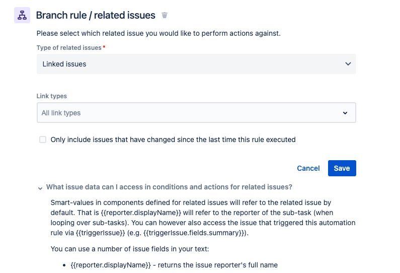

Is there any smart values that work for linked itens, without doing an mult-project rule? Any like {{linked.issue.key}} or {{linkedissue.status}}? Can anyone help me with that?

How are you getting the linked issues?
If you use a branch to get the linked issues, then you use {{issue}} to reference the current linked issue within the branch and {{triggerIssues} to reference the issue that triggered the rule.
If you get the linked issues using the Lookup Issues action, then refer to the docs on how to access issues in that data set. Here's a starting point.

Yeah sorry, it's an automation, so if I use this branch rule am I able to edit the linked item without making an mult-project rule, or am I just able to use smart values based on the linked itens?
You can edit the items without making a multi-project rule. The multi-project rule setting applies to the triggering of the rule, not the actions that you take in the rule after it has been triggered.
