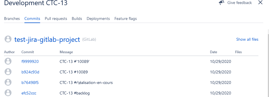

I'm having trouble using some transitions with smart commits.
It appears that issue is limited to transitions having accented characters at the beginning or in the middle of their names.
For example:

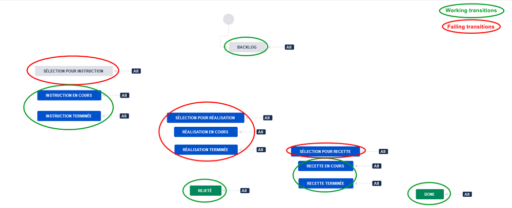

To better explain the issue I'm facing here is a screen shot of the transitions I'm using:
I tried renaming the transition and removing the accented characters from their names but that didn't help.
I also tried using the transition name without accented character but with the same results.
Any help would be greatly appreciated.

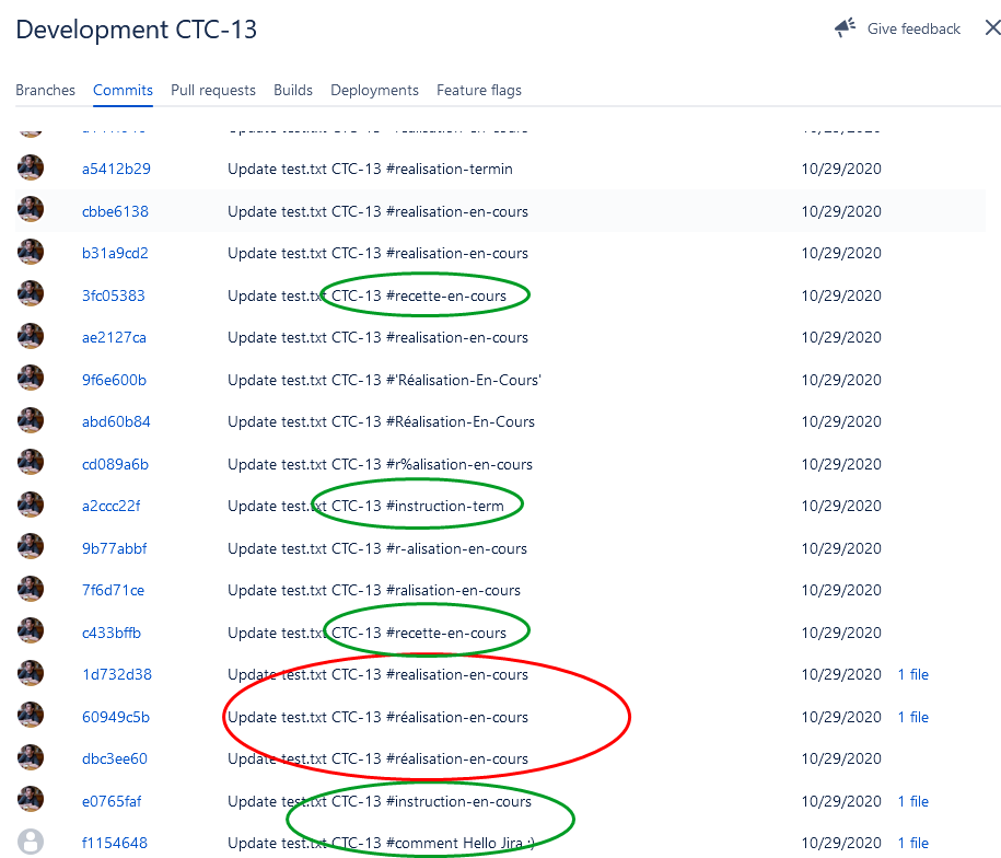

There is not much more to it, those are workflow transitions I'm trying to trigger using smart commits.
I'm not receiving any errors whatsoever.
We can see each message I tried to use on the issue all of them correctly displayed the accented characters: (once again the green ones worked and triggered the transition on the issue and the red one did not and this without any error)
No I don't have statuses values in quotes, I only tried sending them in quotes to see if that would help by any chance but sadly that did not.

The good news is that I've been able to obtain a workaround from the support ticket :
While we were testing this, we found that the workaround to this issue is to rename the workflow transition name to include non-accented characters in the first word. Since the smart commits use workflow transition name and not the workflow status name, we would need to rename the transition name from "réalisation-terminée" to "realisation-terminée".
This seems to allow for the transition to be triggered, but I would actually go even further and suggest scraping any accented characters in the workflow transition name. The workaround would otherwise pick the first (of many transitions) if they contain accented characters after the first word.
As a side note, I haven't had any issues regarding transitions with hyphen(s) in the name, so perhaps double-checking the workflow transition names might be a good place to start.
To edit the workflow transition names without affecting the statuses, you should click on the arrow leading to the status and not on the status itself.
You would then be able to rename that workflow transition without impacting any of your views and filters.
