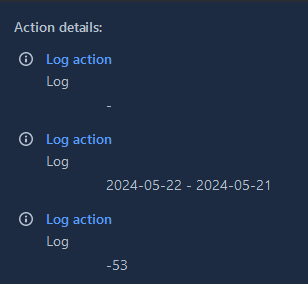

Hi @Trudy Claspill , The root of what I am trying to do is calculate the delta, but that math doesn't work out and the the datedif function doesn't seem to work with the fieldChange values. I tried the basic math, but it spits out -53 when the dates are just 1 apart.
  I suspect from your original reply there might be a team project that someone created the field with the same name. When I go to the admin>custom fields Start date is locked as a system field. I would imagine system fields would have it's own unique identifier like a customField_1234, but I haven't found anything on it.
Interesting that only 1 "-" shows up in the first log action, it should be 2

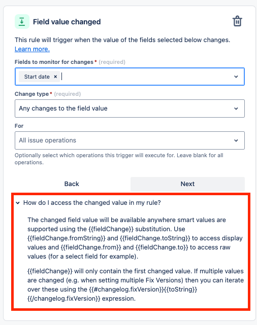

Did you review the information available in the Trigger when you created it?
If you want to reference the original value you would use {{fieldChange.fromString}}. If you wanted to reference the new value you can use either {{fieldChange.toString}} or you can reference the field directly from the trigger issue with {{issue.Start date}}

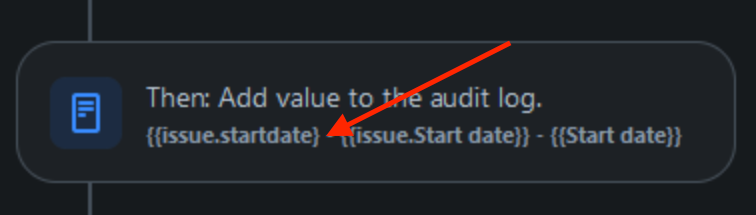

Your syntax is wrong in the first Log Action. You're missing the second curly brace at the end of the first smart value.
