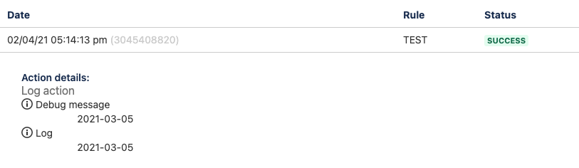

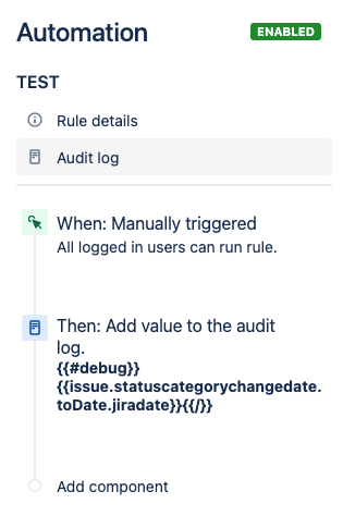

Why mess with REST API? Use Automation TEST Manually to verify.
Thank you Karmene.
Could you please elaborate? How can this automation fill in the field with the date the issue had been transitioned to "in progress" retrospectively (some tickets are already in another status)?
This line:
{{issue.statuscategorychangedate.toDate.jiradate}}only gives back the date of the last transition to whatever status and not specifically the date of "in progress" status.

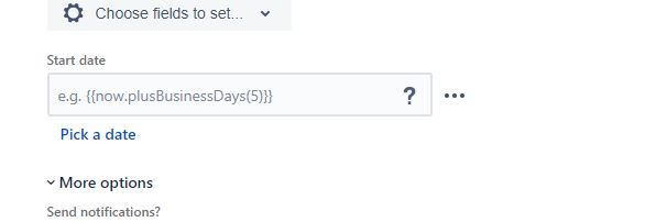

@John Funk's answer seems to be the one I am looking for, but there is a slight issue here that I cannot set a JQL query as a value for the 'Start date' field. Only a smart value or copy from another field's value.
So my plan was to set up a rule like this:
1. Scheduled trigger with a JQL query on all my tickets in the given project.
3. Set the value for 'Start date' based on a {{SMART VALUE}} where the smart value = the date the ticket has been transitioned to 'In Progress'

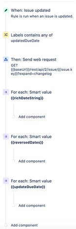

Thank you for your answer! It looks amazing. I'm trying to implement it in my automation but I received some errors.
Error response HTTP body:{"errorMessages":["Issue does not exist or you do not have permission to see it."],"errors":{}}Error publishing webhook. Response HTTP status:404Do you know what can be a reason?
What I want to achieve:
I want to update the Due Date field with the date when the issue changed its status to Resolved.
It looks like a problem with authorization. I checked this rest in the postman and everything works very well. Do you know how to authenticate in the automation?
Yeah this looks a lot like an issue with the authorization or possibly even the account used for authorization not having the right permissions. Did you try postman with the exact same Header and issue key? Maybe check for typos or white-space around the values. Can't really tell you anymore ideas on how to fix this based on the post...
Furthermore once you got the request working, you do not need the bodged way to make this work with the time of resolution.
{{webhookResponse.body.fields.resolutiondate}} should return the value you are looking for - so no need for converting back and forth between list and string with regex and so on.
