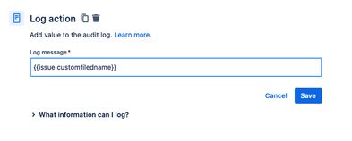

What do you mean that you're smart values are empty exactly? Could you add a Log action component that records the results of the smart value. for example...
Then after executing the rule you can go into the audit log and assess what the value was at the time of execution.

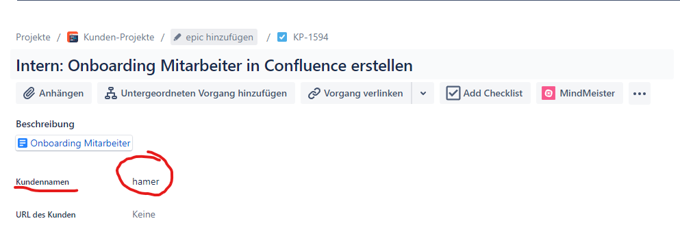

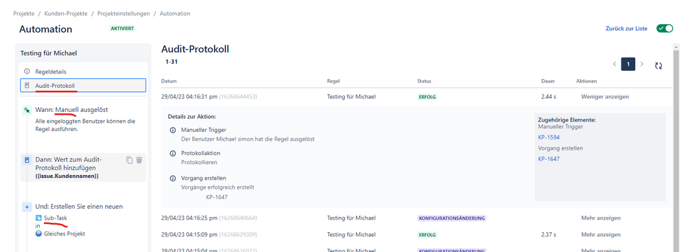

Hi, let me do some sceenshots.
Maybe in different words: Just by changeing the Trigger, the automation doesn't work anymore. :(
In the past, the sub task got created whenever a task got created of a certain type.

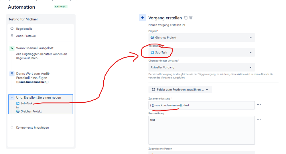

Hi @Jack Brickey ,
in the past, the task creation triggered the action, maybe Jira was able to pull the parent from the trigger itself?
This is why I thought that I could just start the manual trigger directly inside from a parent task and Jira would know automatically, which task will be the parent.
What i would like to do, is to use the manual trigger to create sub-tasks.
And this already works partially.
The Sub-Tasks get created under the correct parent task, after clicking the manual trigger.
But I want to inherit the information from the parent task too, in order to use it in the sub-tasks. But here the automation can't find the information of the parent task and values remain empty.

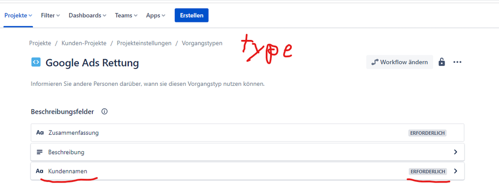

Hi, I somehow solved it.
I used {{issuue.customfieldname}} all this time. But I started to use it on other issue-types as well. Then it seems to be not a unique custom field anymore.
I started to use the custom field ID instead of the name and now it works.
So it seems to not to have anything to do with the trigger, but with the unique naming of a custom field, between different issue-types.
