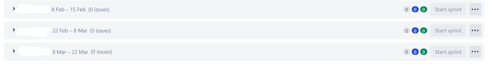

We have a situation in our team-managed project board where suddenly, right after completing a sprint and starting a new one, all previously completed sprints in our project are showing up in the project backlog again, with the historical dates still in there, but somehow seem to be registering as future sprints. We don't want to delete the sprints, as we're not sure what the implications are if we do, and we don't want to lose data or reports.

Hmmm. Have checked, but it's not in the board where the problem lies. It's in the backlog of the project itself where the issue lies. Unfortunately, I am also not the admin for the whole company.
I'll reach out to our primary admin again, but for reference, this is what it looks like. In the example, all 3 of those sprints were completed last year already, but somehow one day, they started showing up as not closed, future sprints.

We figured this one out - our new Copado/Jira/Salesforce sync updated the values of the isCompleted for previous Sprints.
We simply took the manual work road, and closed them all in that way, making sure to check if they had an previously existing tickets.
