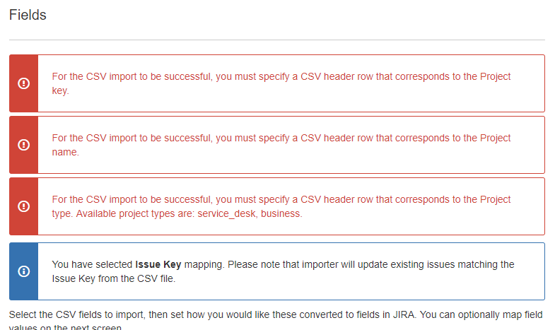

I get that response :

Nicolas DUPRE March 31, 2018
Hi All,
I solve the issue by adding the extras lines
"Project Name": {
"jira.field": "project.name"
"Project Key": {
"jira.field": "project.key"
"Project Type": {
"jira.field": "project.type"
in
config.field.mappings
