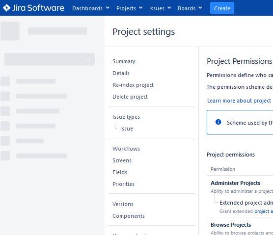

2. The sidebar does not show:
Other POST requests work fine (editing issues etcetera).
