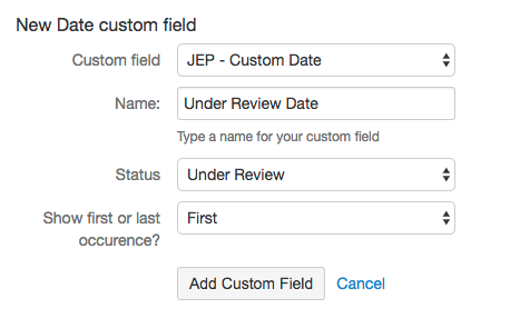

Hi @Lakshmi CH ,
Enhancer Plugin for Jira has date fields that can help you with your requirement.
Just navigate to the Date fields section in the Enhancer plugin for the Jira menu, add your Status Entry Date, select the status you want to show information about, add it to the necessary screens and it'll start capturing details. Alternatively, if it suits your workflow, you can also use built-in First In Progress/Reopened/Closed Status Dates.
You can also obtain historical information about the already existing issues too. These fields are searchable, sortable and you can use them in reports too. Also, JEP has dedicated gadgets that can help you to track your progress.
Please let me know if you have further questions.

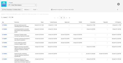

Hello @Lakshmi CH ,
Our app Time in Status might help you about this.
Besides giving reports about how much time each issue spent on each status, assignee or group; Time in Status also gives reports showing the first/last transition dates for each status of each issue.
The app works by processing your existing Jira issue histories so you won't have to modify your workfows, create new custom fields or make any configuration on Jira. You will also be able to report on your past issues.
The app allows you to export data as CSV or XLS.
