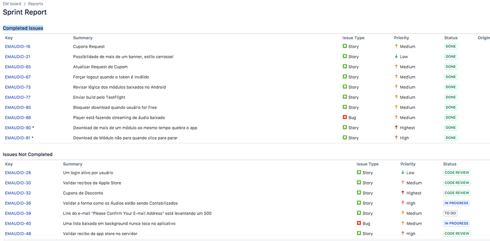

Currently, the sprint reports show issues as completed ("Completed Issues" section) only based on the column name.
Is that possible to generate reports displaying all issues with "statusType == Done" as completed?
For instance, please refer to the screenshot below. I'd like my issues with "status == `Code Review`" to be marked as done in the report, together with the issues with "status == Done". Is that possible?

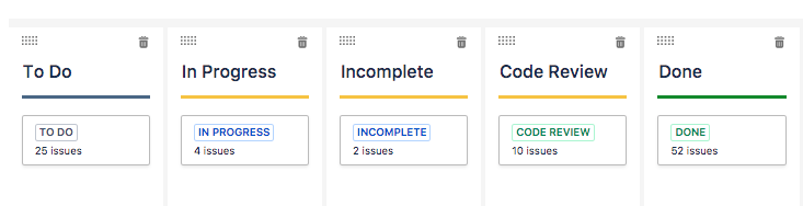

Below are the columns I've being using:

I think you'd have to create a jql query report outside of this.   The sprint report mapping is based on column mapping.
According to documentation:
Sprint Report — an issue is considered complete (done) when it is in a status that is mapped to the 'successful' (rightmost) column in the column configuration.
A JQL might look like:
project = "Projectname" and Sprint = 461 and (status = done or status = Code Review)

Isn’t it enough to create a dedicated board for the report you want, where you set both statuses in the Done column?
