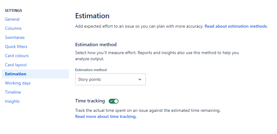

The sprint burndown gadget on my dashboard displays remaining time estimates on the graph. I have recently changed my estimation method to story points:
Is there anything else I need to do to change the estimate method on the burndown gadget? Does 'time tracking' need to be off? It's still useful for my team to log time as well as using story points.
The gadget settings do match the board from the screenshot above, so I'm not sure why it's not displaying story points.

#1. Turn off that "Time tracking" option in your board setting. This will make the gadget display Story Points

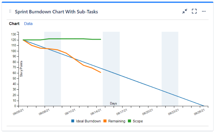

#3. Check for an add-on that provides a better burndown chart gadget - if you can consider a payed add-on, look at the Sprint Burndown Burnup Chart gadget offered by our Great Gadgets app. This let's you choose the estimation type, regardless the board configuration.

I am actually already trialling the Great Gadgets app, so I will be using that instead.

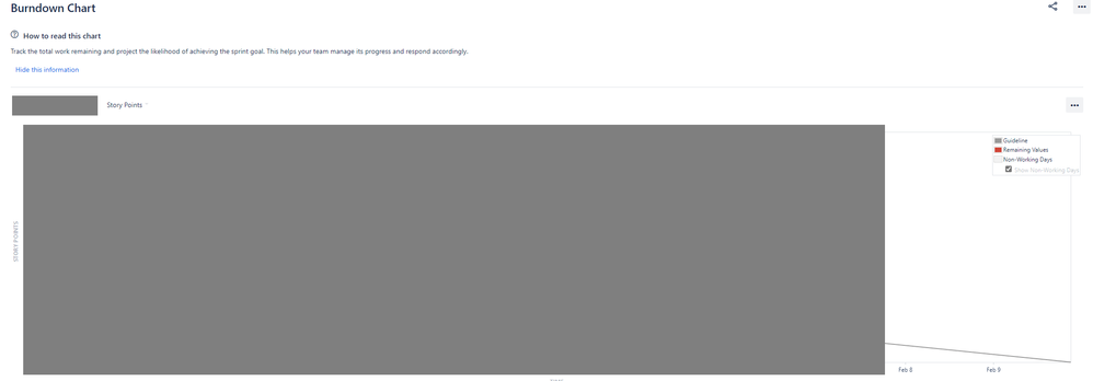

Hi @Nic Brough -Adaptavist- when I check the report section and select burndown chart, it displays the correct information with story points. It's only the dashboard gadget that doesn't work as it should.
