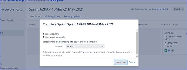

When the popup tells me 1 issue is done, 1 issue is incomplete, It's not referring to the two subtasks because both have the same status Done and because the same message says that the issues referred here are not subtasks
So how do I figure out the incomplete issue? It couldn't be the parent issue itself either because it says 1 issue done, 1 issue incomplete by trying to complete this 1 issue.
The below image clarifies what I mean:
(Subtasks are not included in the total(s) above)
