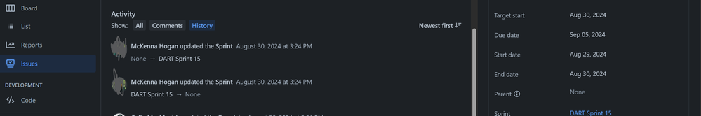

My team has been problems with assigned sprints not showing in the activity history. Normally, when a task is created and assigned to a sprint, there is a history log saying "none -> Sprint x". However, this was not the case with this task. Even though my Sprint value on the right showed Sprint 15, there was no evidence of this in the history.
There was no history log of being assigned to Sprint 15 until I deleted Sprint 15 from the Sprint option, then reassigned it - as you can see in this screenshot
Has anyone else had this problem? Does it have to do with making the task using the create button in the board view instead of the "+create issue" option in the status's themselves? It is creating problems for us when we pull the changelogs via the Jira API.

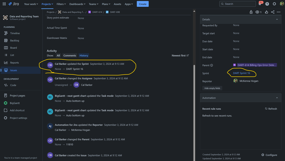

The first screenshot of DART-698 shows that under history, when the task was created then assigned to Sprint 16, there is a changelog showing "none -> sprint 16". This task was created in the epic view. Then the user created the task by using the "+ child" icon. The sprint was a manual assignment by the user.

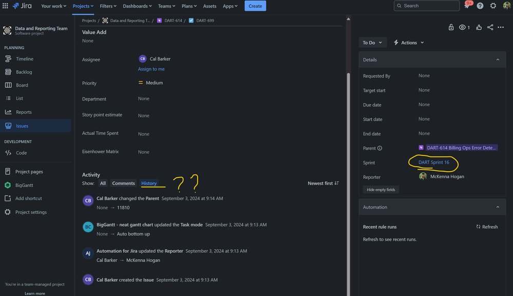

This second screenshot of DART-699 shows that under history, there is no changelog for "none-> sprint 16" even though under details, you can see that it is under sprint 16. The user created this issue by using the "create" button in the board view of our sprint. then manually assigned the sprint.

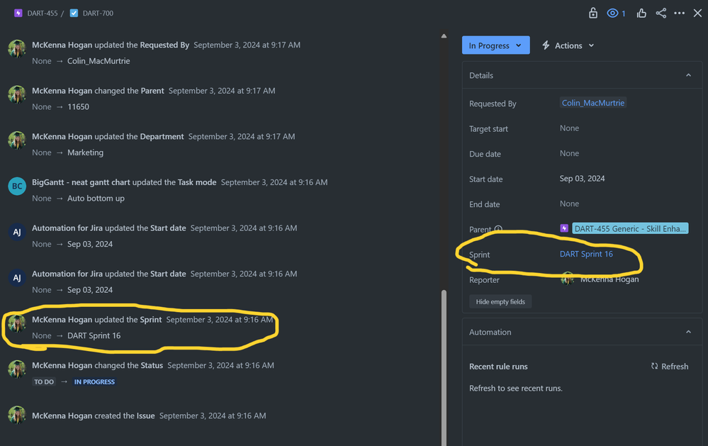

This third screenshot is of DART-700 shows that under history, there is a changelog of "none->sprint 16". This task was created using the "+issue" option under the "in progress" status of our sprint board. Sprint 16 was automatically assigned by Jira
