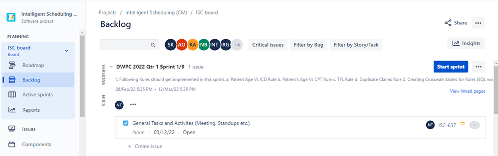

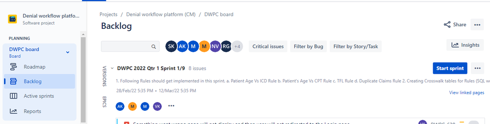

When i create a new sprint in Project Denial , it should be limited to that particular project/ board with its respective board name.
But i can also see that particular sprint name in the other project.

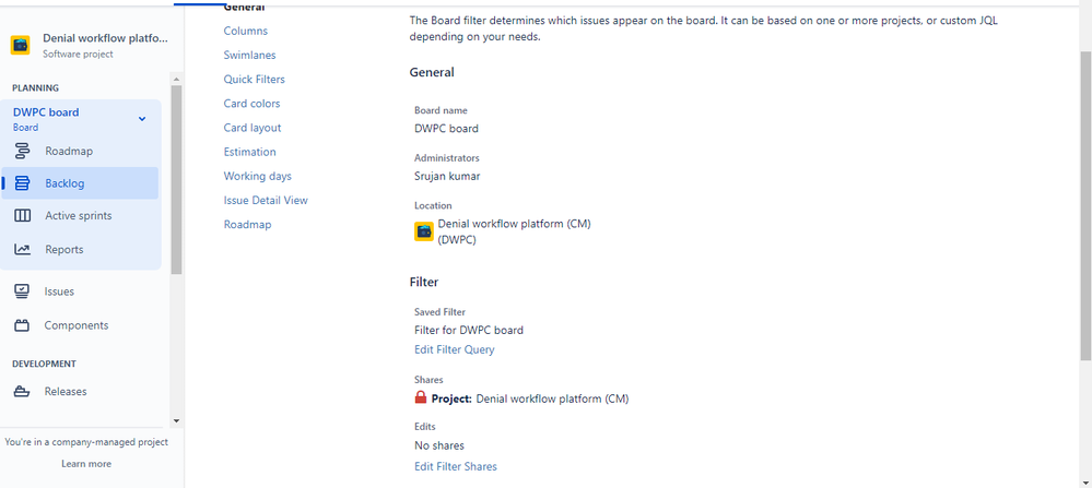

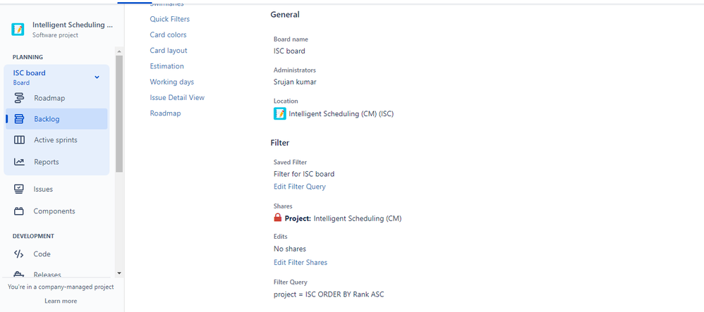

Both are different projects and their board setting, board filters and board locations are different , still reflecting the same sprint name in multiple projects. Below are the screenshots of both board settings.

Could you please click on edit filter query in both of those instances and share the results?
