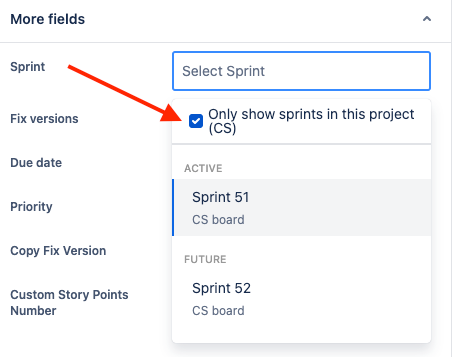

When you say the "sprint field filter" do you mean this?

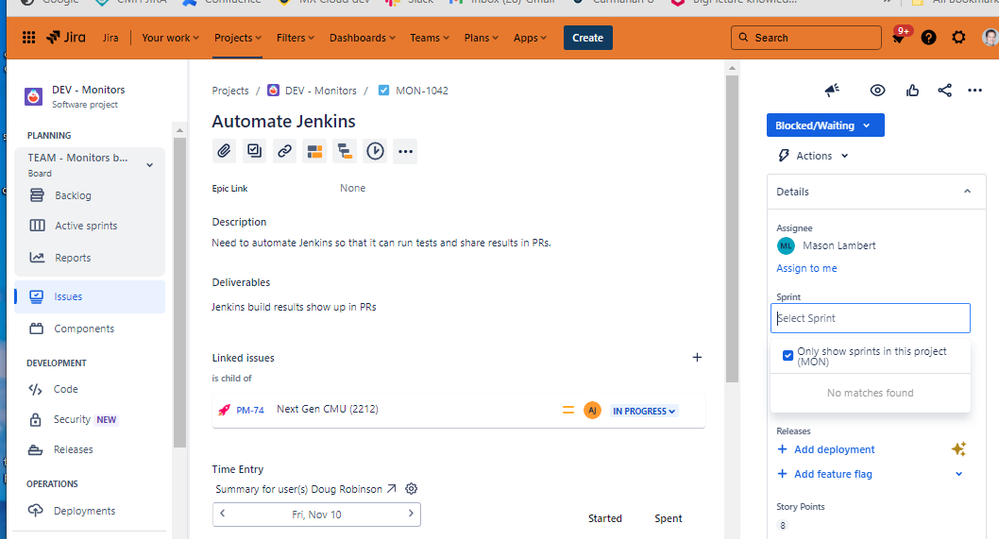

Project "MON" hosts the board, the board has one active sprint (Sprint 26) and two future sprints (Sprint 27 & 28).
If I open MON-1042 (for example) and go to the sprint field, with the filter "ON" it says "no matches found". If I turn the filter "OFF", it is populated with all available sprints in our instance.
If I open an issue from that board that is in a different project, the filter result is empty, but I expected that, based on how I understand it works (and it says it right in the filter txt!
This is only relevant to a couple of teams that stuff all their work into one project, but.. they would appreciate being able to zoom into just their relevant sprints (In the issue screen)

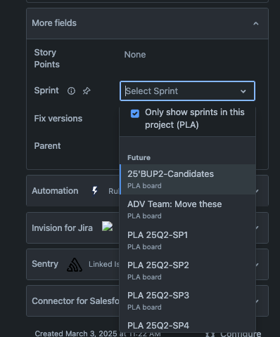

I am also experiencing this issue. No matter what filters I try or permissions I change, "Active" sprints do not show in my sprint field drop down I only have the option for "Future" sprints. Any help would be great!
