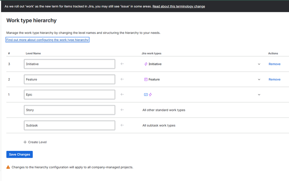

Generally, the Story/Task/Bug are considered standard issue types. This is based on the hierarchy levels.
By default, Epics are level 1, Story/Task/bugs are at level 0 and Subtasks are at -1.
You may navigate to Settings > Work Items and select Work Types from the left menu. All the work types listed at Level 0 are considered standard issue types. Features are usually at level 2, so will be considered as Parent of the Epics.
