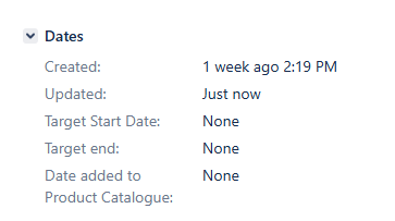

Ah I have both Target Start Date and Target start - maybe that's the issue?Screenshot 2025-03-11 123726.png
Alice Mason
March 11, 2025
Added both to the screen and still not showing :( and still getting success in audit logScreenshot 2025-03-11 124703.png
