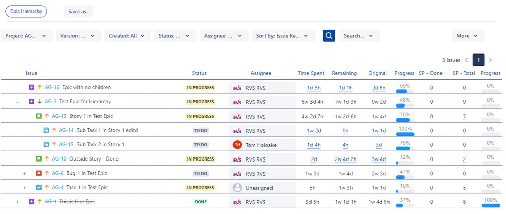

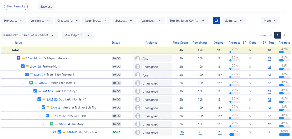

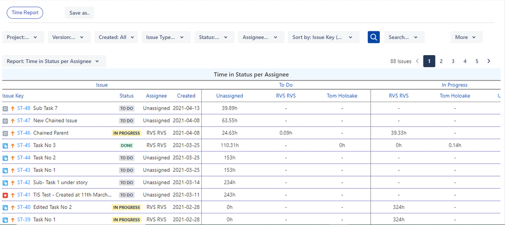

You may want to try out the plugin, Agile Tools : Epic Tree & Time in Status
It provides 3 major functionalities in one add-on
  • Multiple Time in Status Reports
    • Time in Status
    • Time with Assignee
    • Time in Status with Assignee
    • Time with Assignee per Status
    • Status/Assignee Count
    • Multiple Transition Reports
  • Epic Hierarchy / Sum Up (Standard Jira Hierarchy Epic -> Story -> SubTask)
  • Link Hierarchy / Sum Up (Hierarchy based on your issue link, upto 10 level deep)
