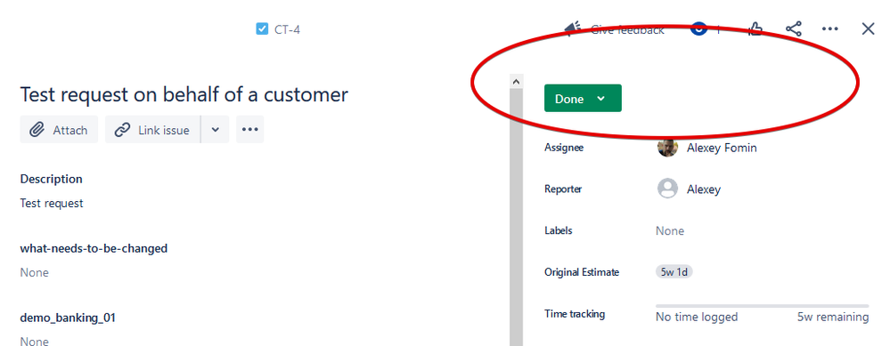

Most likely i messed something with a status mapping, but i cant see where it went wrong and why.
Problem is: some tasks moved to last 'right' column DONE marked as 'Done' (see pic 1.) and some dont (pic 2.).
What i'm trying to achieve? If done, mark as done, if move out of 'Done' do an un-done.
Pic 1. Done and "Done"

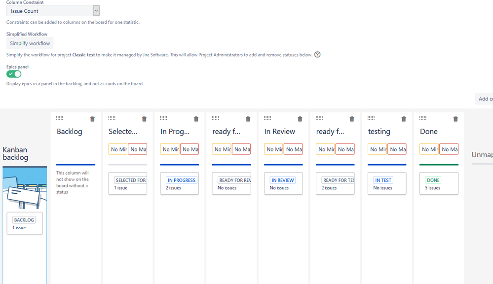

Pic. 2. Just Done status.

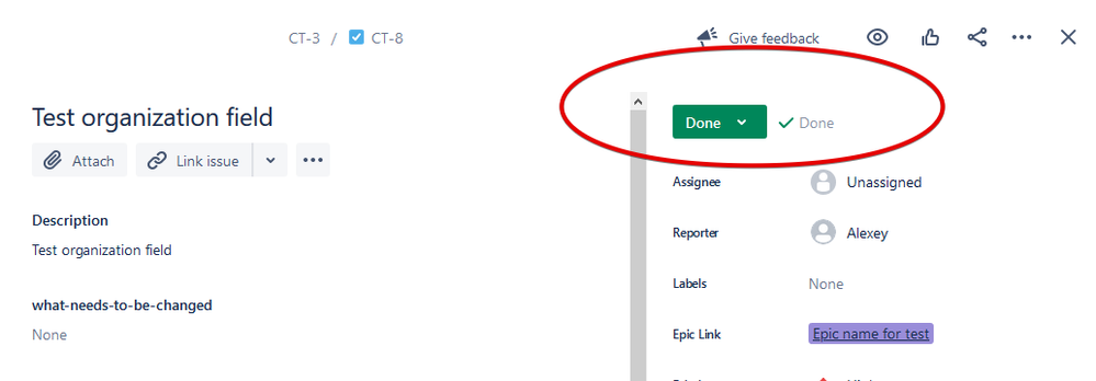

Moreover, is i move those 'Done' tasks back to another status, the task remains strikeout and still marked as done. (see pic 3).
Pic 3. Status change, but resolution not.
I've added screen of my Flow and Board configuration.

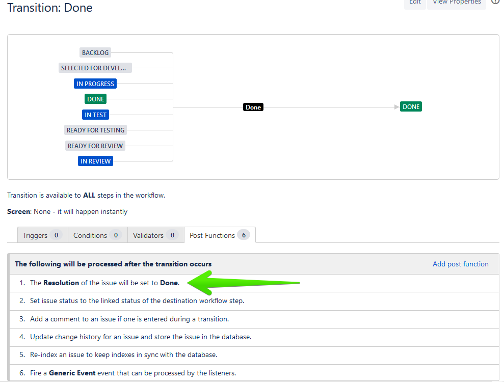

Edit every transition in your workflow.
Thanks! I've created a post-function for done to set as done and for all other statuses clearing that. Not sure why i get broken through, but now i know how to fix it.
Hi @Alexey ,
It's regarding "Resolution" you chosen while moving to "DONE" Status.
For "CT-6" check issue history , may be it moved back from "DONE Status".
In Jira once the "Resolution" is check the ticket will be strike off.
Thanks for the reply, yea, now i added to every non-Done status a post-function to clear the resolution from 'done'.
Yes correct , because all statuses are connected one to all.
