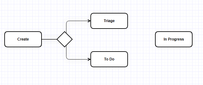

Hi @Avi J , welcome to the community and thanks for your question.
It will not be possible to have two initial states in the workflow so I would suggest to you a workflow like this, where you have initial create status and then you could implement an automation to check some field in the created issue to then transition to either the status of Triage or To Do -
Something like this -
Do you think this solution could work for your use case?
