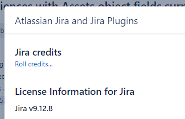

I have asked several times of our cloud/hosting and not received an answer yet. Can I tell by looking somewhere in Jira?
Click on the Help button (labeled with a question mark) near your avatar in the upper right corner and select About. What does it show you? If it shows you a version number like the following, then you are using Jira Server or Jira Data Center (self-hosted). If it doesn't then you are using Jira Cloud.
If you are not an Administrator there is not a definitive way for you to find out what plugins are on your system.
If you can get at least the hosting information using the About option then we don't have to list out all the details for how to try to execute the queries for all types of systems.

Yes, about Jira gives me a license number and version so it appears we are hosted not Cloud. thank you.

So, is there a way to tell which one so I can look at the correct link for syntax help?
I am not aware of a conclusive way for a non-administrator to determine which plugins are installed. With regard to the JQL extending plugins I think one would need to look at the documentation for each one for functionality that is unique and see if that functionality can be used.

I actually have been given some administrator rights....
So, can i see the Add-Ons, Extensions on the Project Administration?
You probably won't be able to identify JQL extending applications from the Project Settings screen. Some apps do add an entry to the Project Settings screen, but usually only if there is some Project-level configuration needed for them.
If you have Jira Administrator permissions you could see the information about installed plugins from the Manage Apps option.

Hello @rachel rutti
The parentEpic() function is not available in Jira Data Center JQL. It is available only in Jira Cloud JQL.
But, to answer your other questions:
No, it cannot take a filter as input.
No, you could not use the same function to get parent Program Epics of Epics. And there is not an option to use the same function for other issues types just by changing the function name.
For information on the native JQL available in Jira Data Center you can refer to this documentation.
https://confluence.atlassian.com/jirasoftwareserver/advanced-searching-939938733.html
Note that link goes to the documentation for Jira DC 9.17. If you are using a different version then you need to select that version in the upper right corner to get the documentation related to your version.
Unfortunately either ParentEpic does not exist in our hosted environment or I do not have access to it. I do have Parent and parentlink. Parent link just gives me what is below my explicit list of epics. I need the actual epic itself and then the subtasks under the stories.
