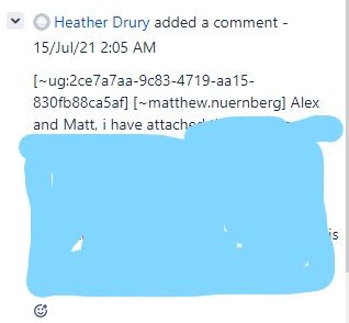

Hi @Vishwas ,
After running the query in the DB, it has changed some of the accountIDs to the username in comments but not all of them (Attaching the screenshots , so you can see it).
Not sure, why it didn't work for all of the accountIDs.
Pls let me know what i am missing here.
Thanks for all your help!
Hi
@Shreesh Narayan Singh looks like it has updated few of the usernames I guess and some of the usernames are not updated.
Can you just check that by taking one AccountId and see does that account name is part of user in the directory ? Like correlation type. After try running SQL query once again.
