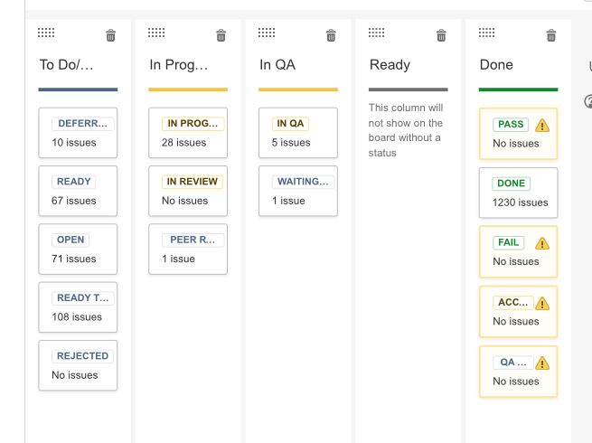

Can you share a screenshot of your column configuration?
@Jeffrey Luna , i see that the 'Done' status is mapped to the right most column 'Done'. So it should actually work.
Can you un-map the old statuses from Done column and remove them? I dont think that causes this.. but just to clear it off the problematic cause...

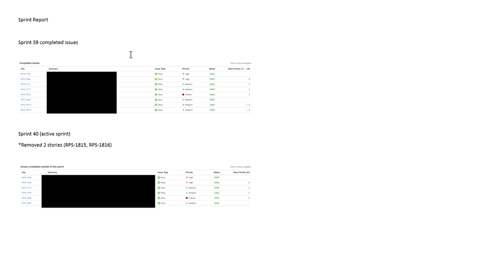

Attaching docs for sprint report
Not the sprint report.. When you complete the sprint next time, take a snap of the 'Sprint complete screen' that says " x number of issues are done and y number of issues are incomplete and would move to next sprint. "
I cant see the sprint report clearly.. But is it possible that the dates of the sprints are not actual reality? I mean, do you set the new sprint start date as a past date from the actual clicking of 'Start sprint' button?
Thats to check the possibility that the you have set a past date to the new sprint and the issues in question were completed in that time frame.

Here's the screenshot of possible issue. The story status is Done but when I check it in the board, it's still in the To Do column.
Is the column configuration you gave in earlier comment is of the same board? I see that the column config has 'To do/<..>' but its different in the board above...
Can you check the board config -> column of this particular board to see which column the 'done' status is mapped to?

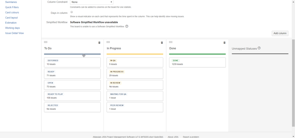

Yes. It's different. Sorry for the confusion. Below screenshot is the board config. You're correct, JIRA don't recognize the issue as Done unless it is in the Done column in the board. That's why issues in the previous sprint (has a status Done, but not move to Done column) is included in the active sprint. Please correct me if I'm wrong. Thank you!
pwww.. that clears it.. I was wondering what else could be the reason.. :)
Yes, In a scrum board, an issue is considered DONE only after it reaches the right most column. In your case, it is the 'done' column.. but it can be named anything.. All it matters is the 'right most'
