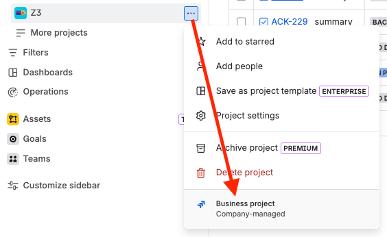

What type of project does this concern? Get that information by clicking the ... button next to the project name in the panel on the left.
EDIT: Disregard the above - not relevant to data center.

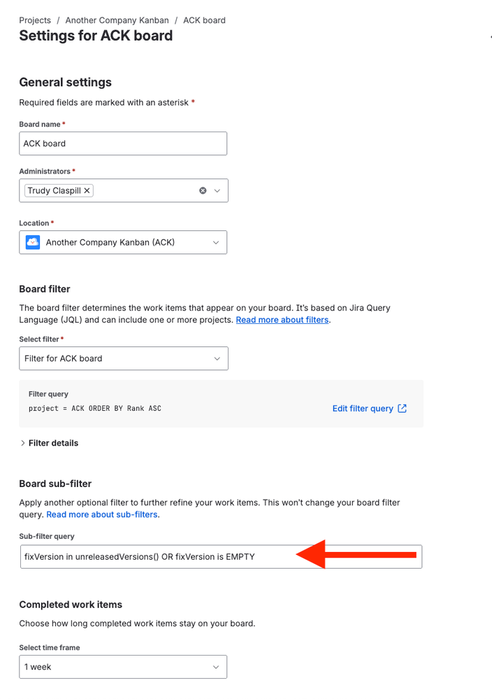

There are a couple of things to check.
Items may be removed from the rightmost column of a Kanban board due to the setting to "hide completed items" which is available in some Kanban boards.
In Kanban boards created in Company Managed Software projects or from Saved filters there is a Board Sub-filter option for the board that can cause items to be hidden from view.
EDIT: The image below is from Jira Cloud, but there is a similar option available in Jira Data Center also in Software project Kanban boards.

My comment about the Board sub-filter still applies. My screen image is from Jira Cloud, but there is a similar option in Data Center in the board settings/configuration for a Kanban board.
