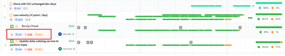

Hey @David Childers - my recommendation would be to think of 1 story point as 1 day. Some people don't agree with this (edit: see!) but I don't really understand why - eventually the story point estimate is converted to time because the whole point of the exercise is to be able to identify tasks that took more time than expected - why not keep things 1:1?
Either way - what you're looking at when you compare how long you thought something would take to how long it actually took is called velocity and identifying low velocity tasks is exactly what you are setting out to do.
Our solution (minware) could potentially help - we automatically calculate velocity at the task level without any worklog or timekeeping required (super cool technology) and flag the Low Velocity tasks that took longer than expected.
Here I'm showing a task that we thought would take 3 days and it ended up taking closer to 7 and was flagged by our Low Velocity notification:
You can expand each ticket and drill all of the way down to the commit level and talk about the task / what took so long.
minware is a 3rd party and it is a paid service but provides a ton of value - this is just one of thousands of metrics we offer to help your teams improve estimation and velocity.
