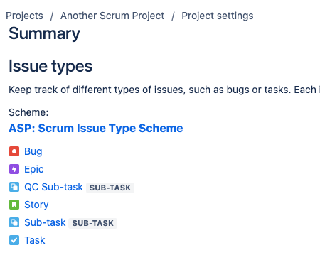

Can you show us a screen image from your Project Settings > Summary page for the Issue Types Scheme? Example:
Here is an example from the backlog, as well as a screenshot of the Issue Type Scheme

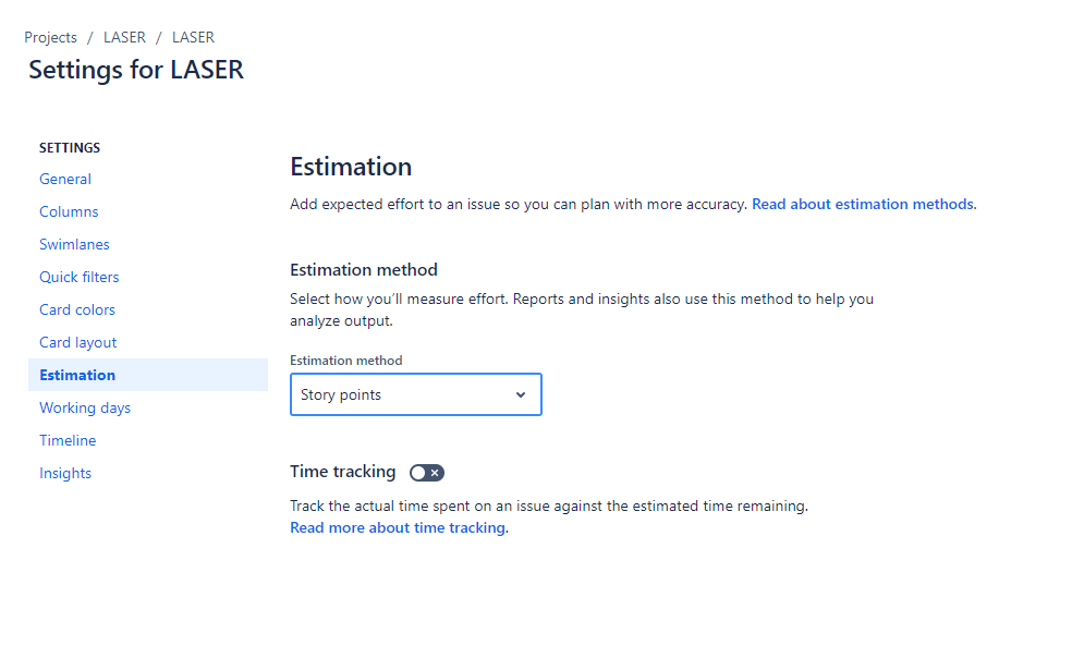

Can you share with us a screen image of the Estimation page from your Board Configuration so we can confirm what you selected there?

Here are the requested screenshots

Estimation Settings
Thank you for those additional screen images.
At this point I am not seeing anything that explains why this is occurring.
