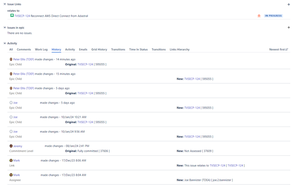

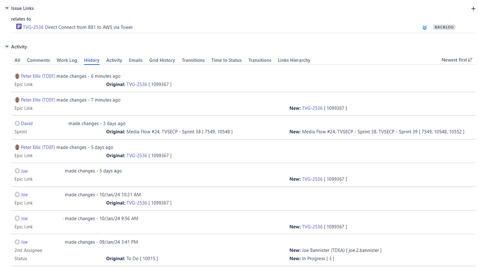

Hi Nic, I have attached the history section of the tickets involved. Nothing else changed when the epic link was added.
Given your board filter, and that nothing else on the issue has changed according to the history, I am pretty much stuck.
