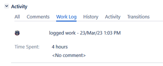

I have a structure with issues and subtasks that have work logs against them.
I would like to sum the work logged between a certain date range using the Jira Structure formula column.
This unexpectedly returns values but the .filter operator is wrong "< sprintStart":

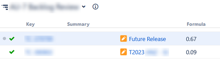

This however, with the correct operator returns nothing "> sprintStart":
WITH workLogged =
worklogs
.FILTER( $.startDate > sprintStart )
.FILTER( $.startDate < sprintEnd )
.timeSpent.SUM() :
jira_days(workLogged)

Thanks for getting back to me. I ended up using the .Filter a little differently. Perhaps trying to use two was causing an issue but the following seemed to work for me.
WITH endDate =
DATETIME("9/May/2023 12:00 AM", "en_AU", "Australia/Melbourne")+86400000 : /*end date plus 1 day*/
WITH startDate =
endDate - (86400000 * 13) : /*end date minus 13 days*/
WITH workLogged =
worklogs
.FILTER( $.startDate > startDate AND $.startDate < endDate )
.timeSpent.SUM() :
CEILING(jira_days(workLogged),3)
