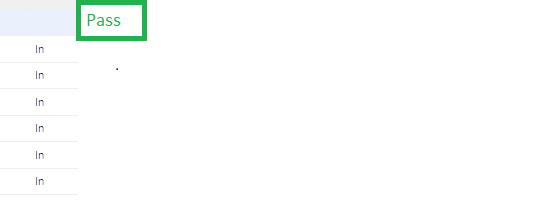

I want to create a formula field and show "Pass" in green at feature level when all the requirements are marked as IN, "Pass" in yellow when some are marked IN and "Not Passed" in Red when all are marked OUT.
I have an IN/OUT checkbox field at requirement level.

Hello @Aditya Sastry
You can try a formula like this:
if issuetype = "Feature":
with total_yes = sum#strict{field_name = "IN"}:
if total_yes = sum#strict{1}: "{color:green}Pass{color}" else
if total_yes = 0: "{color:red}Pass{color}" else
"{color:orange}Pass{color}"
The Format of the column should be set as Wiki Markup.

Thanks Stephan, It worked. few changes I need - If there are no linked issues (Requirement) with the Feature, it shouldn't show anything. Currently it is showing as "Pass", if there is no requirements associated. Also can you help in coloring the background as well.
Thanks again in advance for responding.
Aditya
This should do it:
if issuetype = "Feature" and sum#strict{1}>0:
if total_yes = sum#strict{1}: "{panel:bgColor=green}{color:white}Pass{color}{panel}" else
if total_yes = 0: "{panel:bgColor=red}{color:white}Pass{color}{panel}" else
"{panel:bgColor=orange}{color:white}Pass{color}{panel}"
