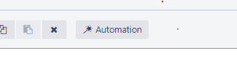

Hello @Els Vercauteren ,
We will need to know if you are on a Cloud or On-Prem instance of Jira for the next step. When looking at a Structure, do you see a button called "Automation" or one called "Show Generators"?
If you see "Show Generators", you are on Cloud and the solution provided is not yet available. Unfortunately there is no other workaround.
If you see "Automation", you are On-Prem and you we can make use of Group by Attribute and set the attribute to Formula. (note: this requires Structure 7.4 or higher)

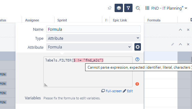

Hello i tried but got issue.
Label i don't need is in reality "fnd_m2c"
What i did
- made new column and added formula
I probably do something wrong
Could you please check the version of Structure you are currently using? The proposed solution works in 7.0 and above.
To find the version, please click on the info button, bottom right corner of structure.
Best,
David
