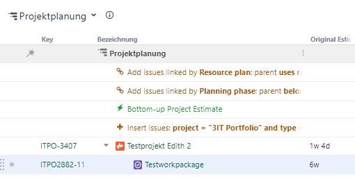

In any case, the effector sets the values, but it is wrong.
For 6w as in the example above effector is getting 1w 4d somehow.
Do anyone know why and how to correct this?

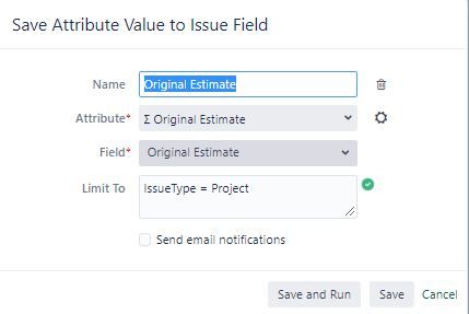

and assignment is made via the effector to the jira field OriginalEstimate.

David from ALM Works here.  To @Dave Mathijs 's point, the screenshot you shared shows an Original Estimate (field value) column, which is not the same as ∑Original Estimate (field value & aggregation).
This would indicate 1w 4d is the value set for the Original Estimate field on your Project issue, not an aggregation of the issues below it.

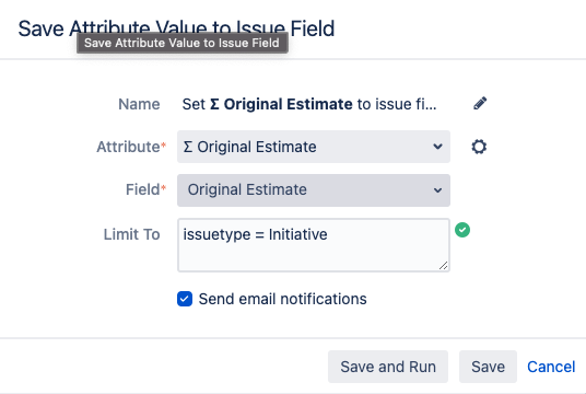

If I understand correctly, you are saying that this 1w 4d was set via your "bottom-up project estimate" effector.  Is this correct?  If so, could you please share a screenshot of the Effector configuration?
It should look like this:
In my example, I am setting the level to run the effector as "initiative" you would want "project".

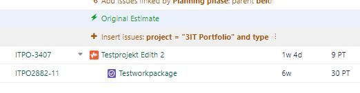

I tried what you said, but I'm getting the same problem.
here I added everything I set up and how I set it up exactly. I still don’t understand why I’m getting the wrong number.

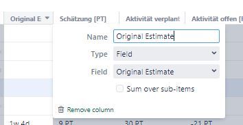

Does the built-in ∑ Original Estimate formula not work correctly then?
Jurica Petricevic
May 9, 2022
@Dave Mathijs
As you can see in the picture, it doesn't work. 6w should be 6w but he is simply miscalculating the time for some reason.
Dave Mathijs
May 9, 2022
Looking at the picture, you're not using the correct built-in formula, it should be ∑ Original Estimate, not Original Estimate.
Does ITPO-3407 have its own Original Estimate filled out (i.e. 1w 4d)?

no, the project issue has no value, it will only be entered via Effector, but as I said, the entered value is wrong.
in this case it needs a pure rewriting of values, but even that formula doesn't work exactly.
