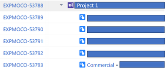

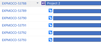

I'm looking to have a structure which shows new demand tickets which show only the sub-tasks of a specific name (i.e Commercial).
i.e. the structure would show Project 1 as that has a sub-task called Commercial, but it would not show Project 2 as there is no sub-task called Commercial

Hello @Kate McGladdery
You can achieve the described by first building the structure in full - with all Sub-tasks and their parent New Demands - and then applying a JQL-based Filter generator to it. If you add a filter with query: summary ~ Commercial and set it to work on All levels in its configuration, then as a result, only issues that match the query (Sub-tasks in this case) will be displayed. And since Structure always preserves the hierarchy and it can't show sub-items without their direct parent items, New Demands of matching Sub-tasks will always remain.

Thanks so much @Stepan Kholodov _Tempo_ this has definitely got it closer to where it needs to be.
slight issue is that I have some new demand tickets which include Commerical in their summary. Is there any way to filter these ones out to just show where there is commercial in the sub-tasks?
Sure, you can add type = sub-task and in the front of the JQL query, and the filter will only focus on Sub-tasks.
