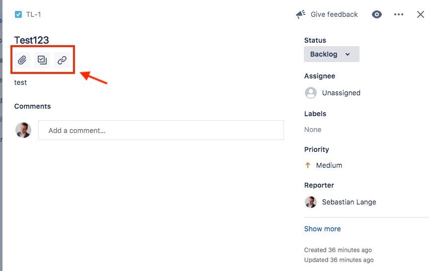

We're using JIRA Cloud and we really like the new UI. On a Kanban board of one of our projects there're the Quick-add buttons (as explained in the documentation) for attachments, subtasks, and link issues:

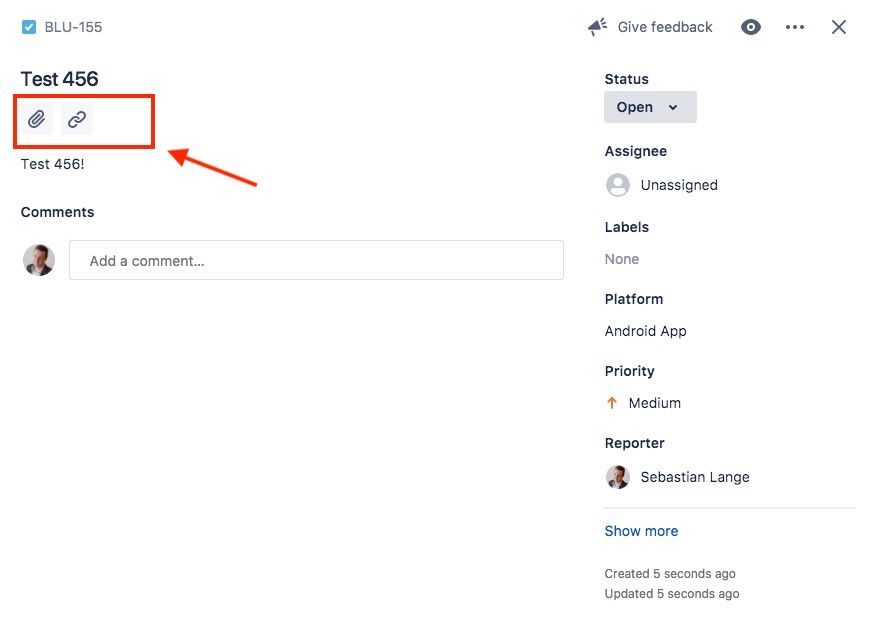

But in another project the one button for creating subtasks is missing:
The project configurations are not equal but quite similar. We looked at board configurations, issue type schemes, etc. but we couldn't find a setting for this.
Any idea how to get the sub-task button back?

Sebastian Lange January 2, 2018
Ok , I found the problem! :)
If you have a custom field that is set as Required the button disappears. In my case we have a mandatory "platform" field where you have to set the correct target platform for a subtask.

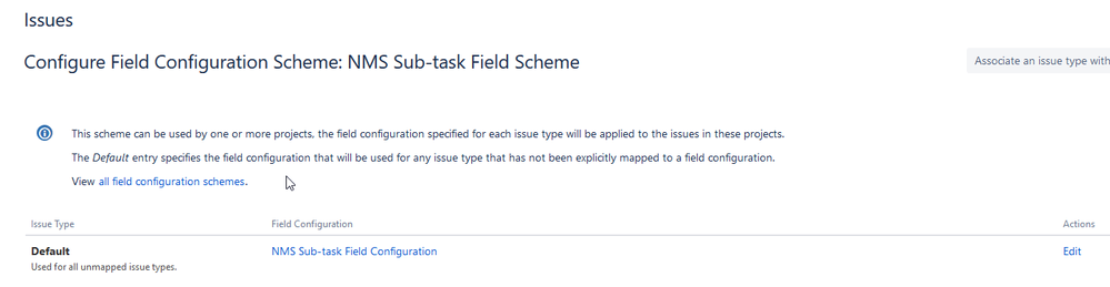

My Create subtask button disappeared when I set the "Due date" to mandatory...

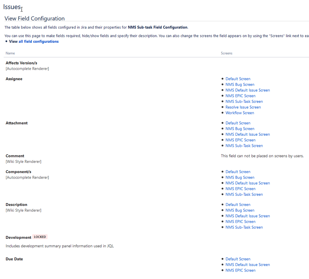

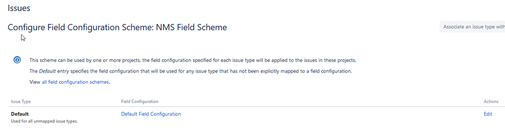

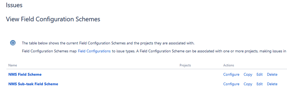

As for the answer to Anant:
I resolved this configuration by creating a separate field configuration, where Sub-Task were not included and due date was not configured as mandatory.
I also create separate screen just for sub-task and that screed is not used for field configuration.
I am not sure, if everything I did is correct, but at least it is working now:
Like this you can basically define required fields based on issue type - because not all issues have all the field that you would like to set to required for other issues...
Although I fixed ti this way, I found it to be rather complicated to set-up, because whether the icon appears is based on some setting that apparently has very little connection to it.

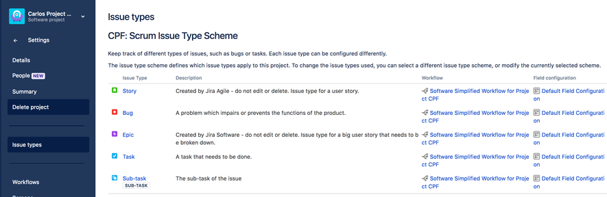

Carlos Garcia Navarro
January 2, 2018
Hi Sebastian,
Do you have any sub-task listed in the issue types section of project BLU? You can check this in project settings-> Issue type:
Hi Carlos,
yes, the issue type is there:
