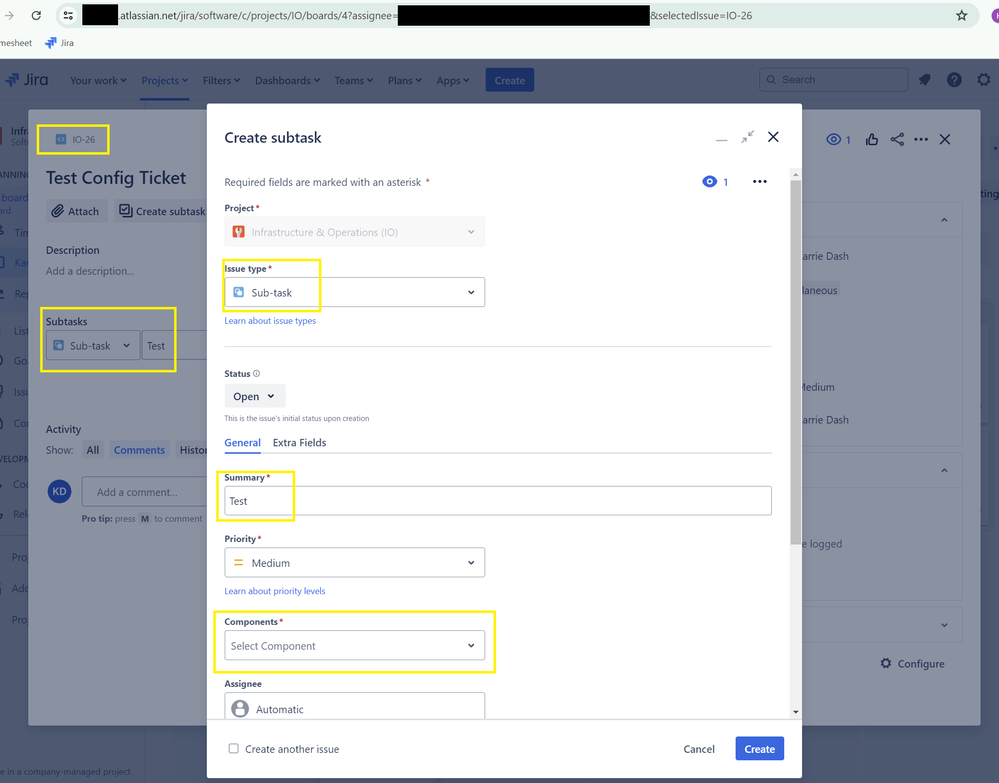

When creating a subtask while viewing the issue in a pop-up module the following error message sometimes appears after I type the task name and click on CREATE.
This does not happen for all tickets. Only some tickets, even if they are the same issue type.
Example: Viewing the parent task from a board.

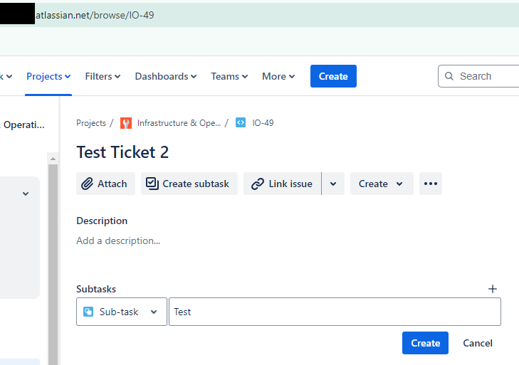

If I go directly to the ticket link (ex: https://XYZ.atlassian.net/browse/IO-36), I can create a sub-task ticket.
When I enter a ticket name and click on CREATE, the Create Issue screen appears (as expected)

When you open the issue from the project board, a pop-up window for the parent issue is created. If the subtask requires a component, you need to open the issue creation screen to fill in that field.
However, because you already have a pop-up open for the parent issue, it's not possible to have a second pop-up open for the subtask creation screen.
For that reason, you see the warning message, and the issue is not created.
The workaround, as you've already mentioned, is to go to the parent issue in order to have the pop-up for the subtask creation screen.

In some tickets, I am able to successfully view the Create Issue screen while the parent issue is opened in a pop-up window.
