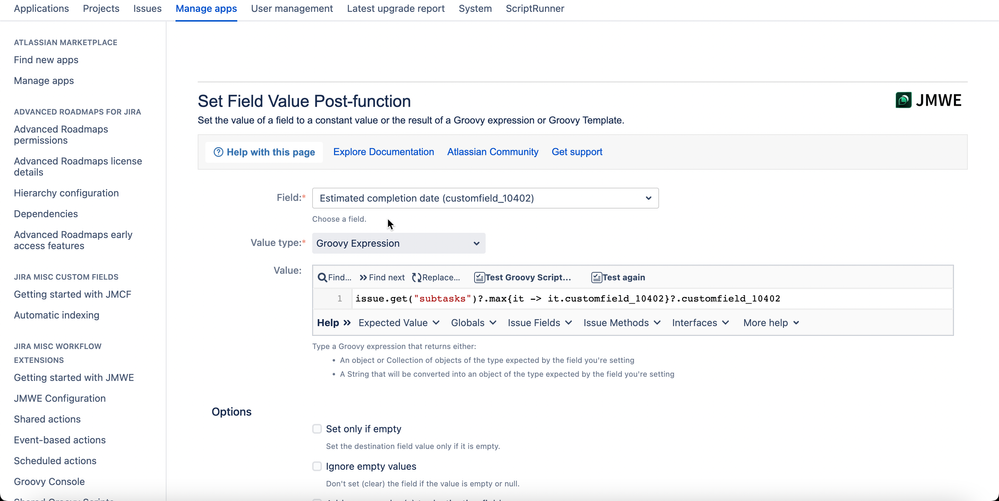

To achieve this with JMWE, you will need to use Set field value (JMWE app) post-function with the following code:
issue.get("subtasks")?.max{it -> it.customfield_10402}?.customfield_10402
You will need to replace  customfield_10402 with "Estimated completion date" ID, I hope it helps and let me know how it goes.

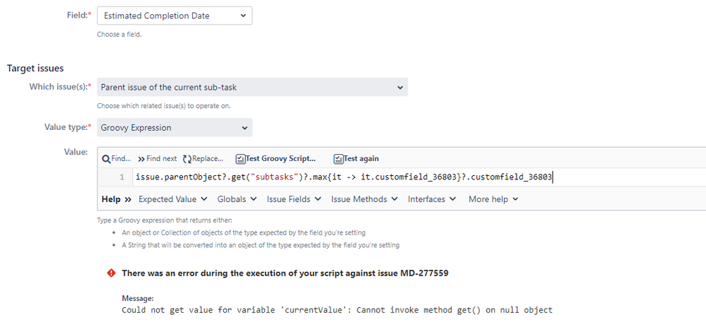

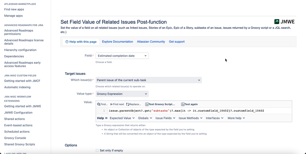

If you are setting the Parent's Estimated Completion Date from the subtasks workflow then you will need to use Set field value of related issues (JMWE app) post-function with the following code:
issue.parentObject?.get("subtasks")?.max{it -> it.customfield_10402}?.customfield_10402

@Sayed Bares [ServiceRocket] ,
 Thank you for your quick assistance on this. I have added this post function on main issue type and Create transition, but the values of the main task is not changing with the furthest date. Am I doing any mistake here ?

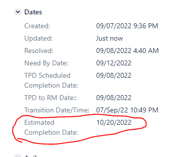

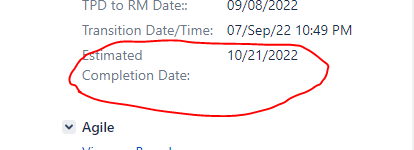

Hi @Sayed Bares [ServiceRocket] , Appreciate for your quick reply. I have added this code on main ticket create transition
 Its showing the correct value when I testing in the workflow post function
But the right value (which is subtasks furthest away "Estimated Completion Date") is not updating on Main ticket

Isn't that the expected behaviour? you wanted to set the main task with the furthest subtask "Estimated completion date"?
jira_admin_cu
October 28, 2022
@Sayed Bares [ServiceRocket] , The right value (which is subtasks furthest away "Estimated Completion Date") is not updating on Main ticket.
