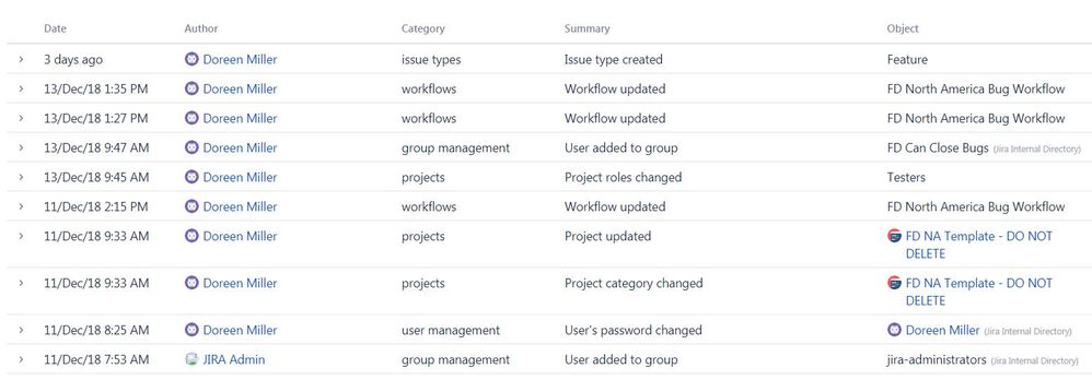

Do this go to cog - > system -> Audit log
And there you will see the log who changed what and when.

I tried checking logs but that did not giving any information about role change.
User is not able to see board, also I checked using admin login & not able to see board for any project.
Is there any option to check when it got removed?
Something from Database?
Nothing here is indicating that.
