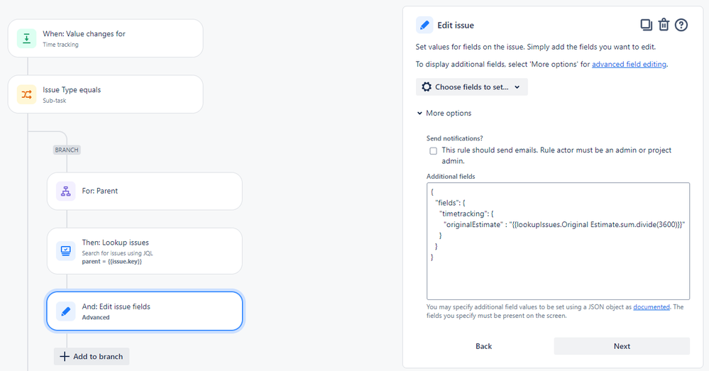

I would like to sum the original estimate field of a parent (epic, task, story) from subtasks. My automation works for weeks, days and hours but not for minutes :(
And for exemple, if I have 2 tickets with 35m and 25m it will not sum and add 1h.
Do you have a solution for that ?

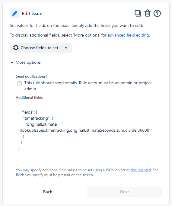

I tried to modify the "edit issue" with what you told me but it didn't work (see the screenshot).

How about this: remove the divide by 3600 and add the units of measure of seconds:
"{{lookupIssues.timetracking.originalEstimateSeconds.sum}}s"
I hypothesize there is some truncation happening and this would confirm / resolve that.

Now, I have this problem, and the sum still doesn't work for minutes but works for hours/days/weeks.

After experimenting a bit I confirmed three things:
  • when the time tracking Original Estimate and Remaining Estimate values are set with JSON, they are always in integer minutes
  • passing a unit of measure does not alter that behavior
  • passing a non-integer value causes it to "floor" the value down to the nearest integer
And so this JSON will correctly set the value from the lookup values:
"fields": {
"timetracking": {
"originalEstimate" : "{{lookupIssues.timetracking.originalEstimateSeconds.sum.divide(60)}}"
I will go back and strikethrough my earlier, incorrect suggestions.

Hello @Bill Sheboy ,
This solution doesn't work. 2h (child) => 3w (parent). I tried to modify "divide(60)" with "divide(3600)" but the minutes are not record.
I don't know how to manage this problem...
